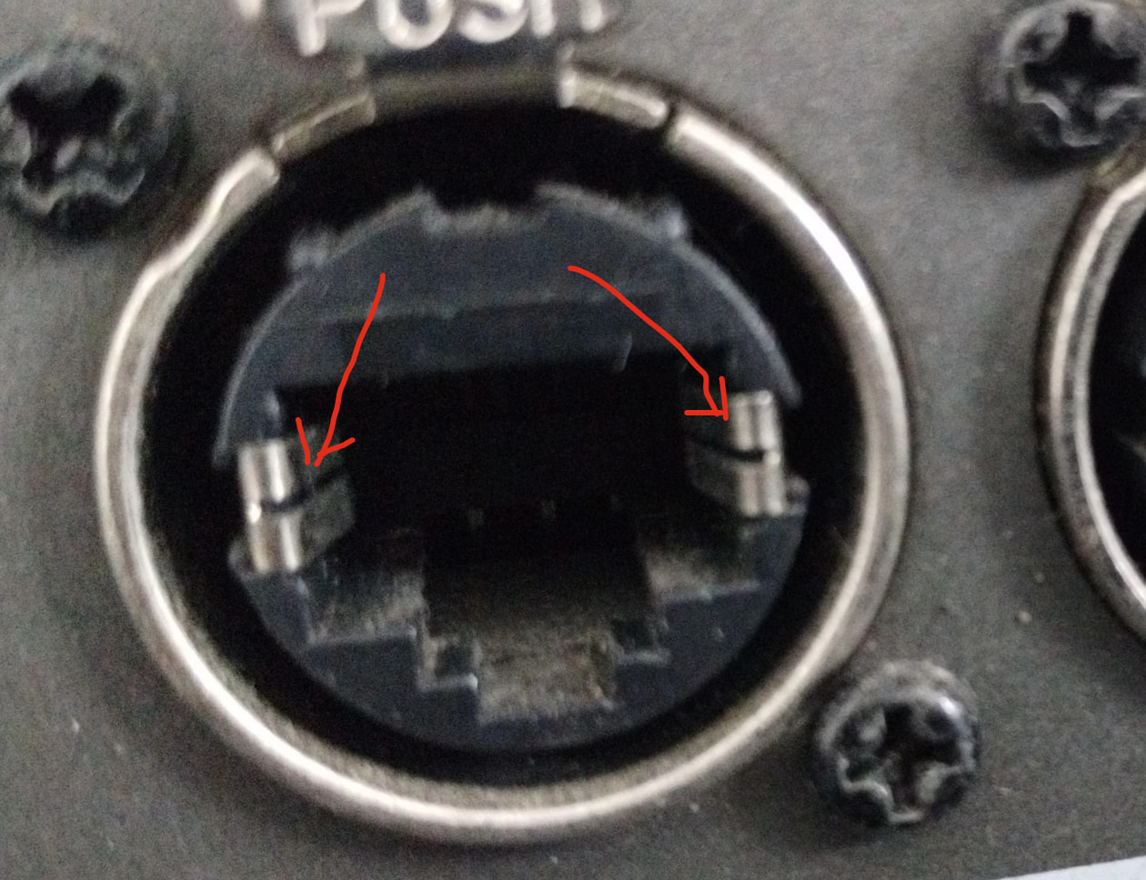

The network plugs used for the AES50 connection has to have two metal plates on its side which interact with the AES50/Ethercon connector on the SD16 and X32/M32. These need to have good contact (this is what connects the metal chassis from the SD16 to the mixer). Without that connection different potentials can cause these dropouts or destroy your receiver/transmitter chip - that happend to some users.

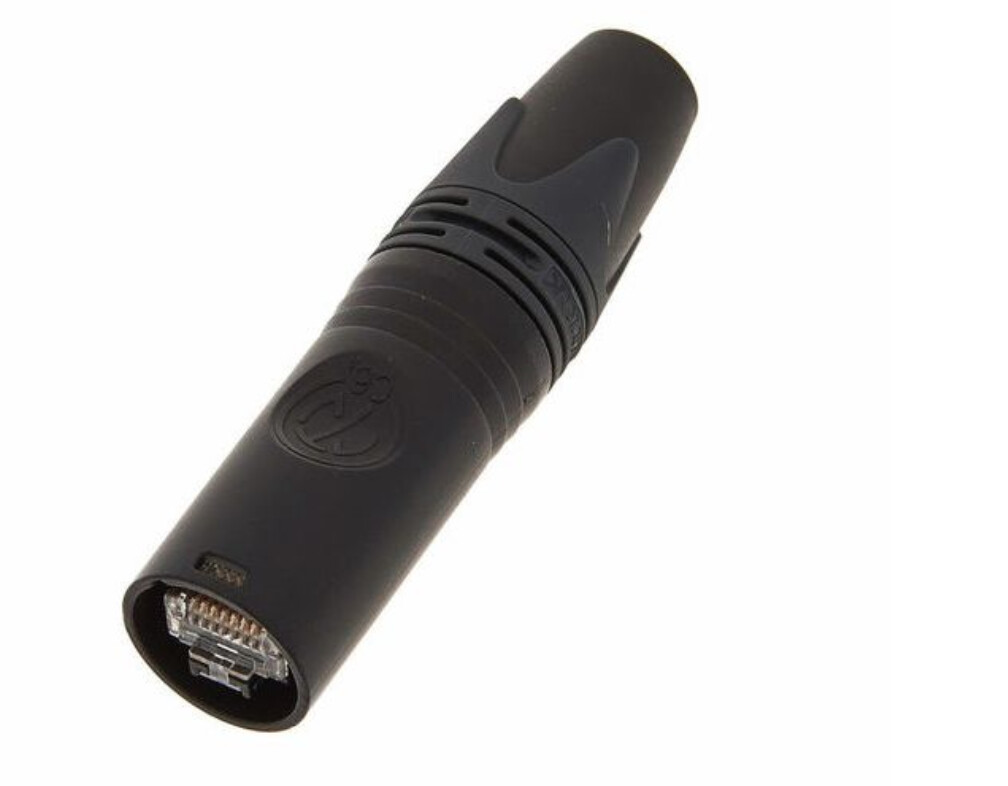

Also don’t use regular network plugs, as these can move in the connector. I had these popping noises myself on a band weekend with a regular 30m network cable.
As soon as I changed the plugs to proper shielded(!) Ethercon connectors the cable was rock solid and stable.
Also note, that all the Behringer gear wants to be used with shielded CAT5 cable.
