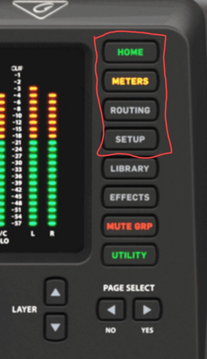

Entering Surface Test Mode
X32 FULL
Hold HOME, METERS, ROUTING and SETUP pressed while powering on the Console
