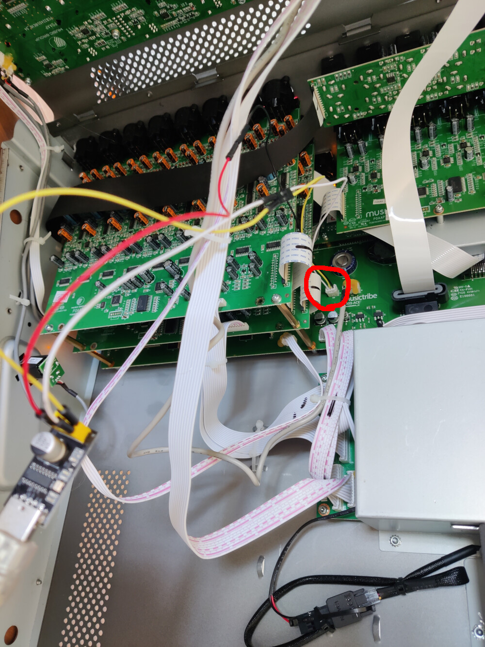

Pinout: GND + RX/TX (turn console off and use a multimeter to find ground)
Serial: 38400 Baud 8n1

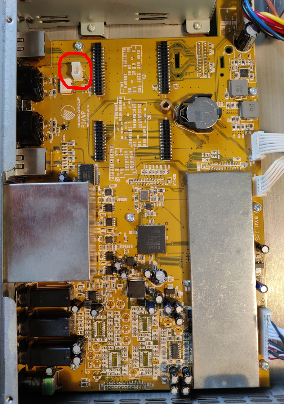

X32 Core
Port X10 on the Main PCB near the Midi ports
X32 Compact
Port X18 on the Main PCB
