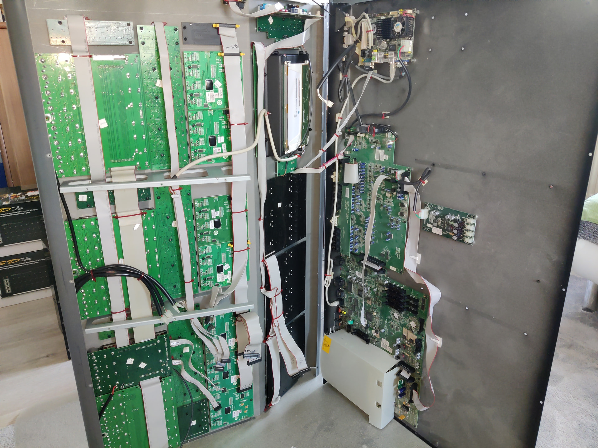

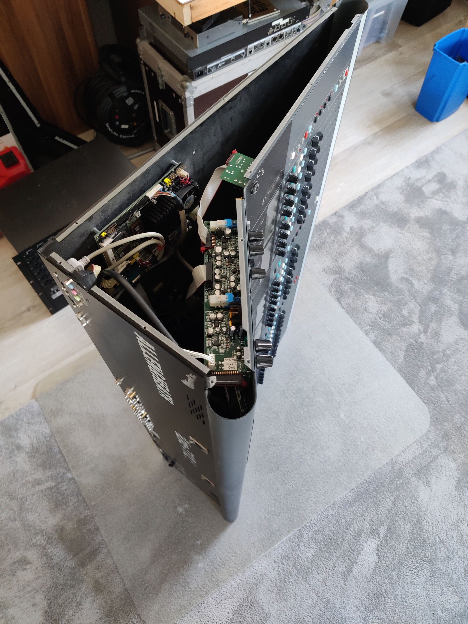

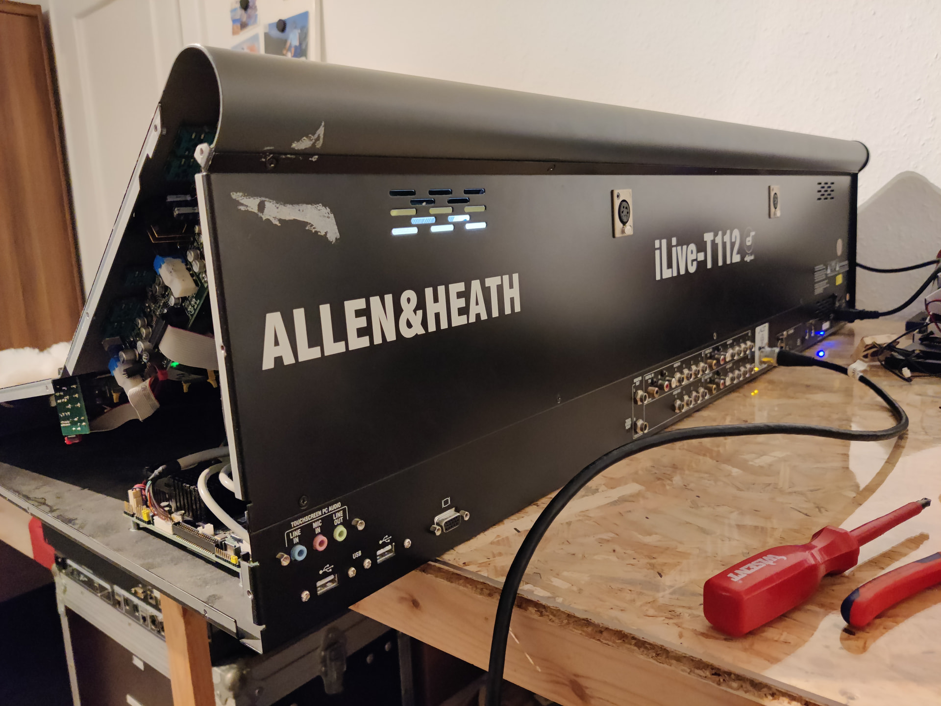

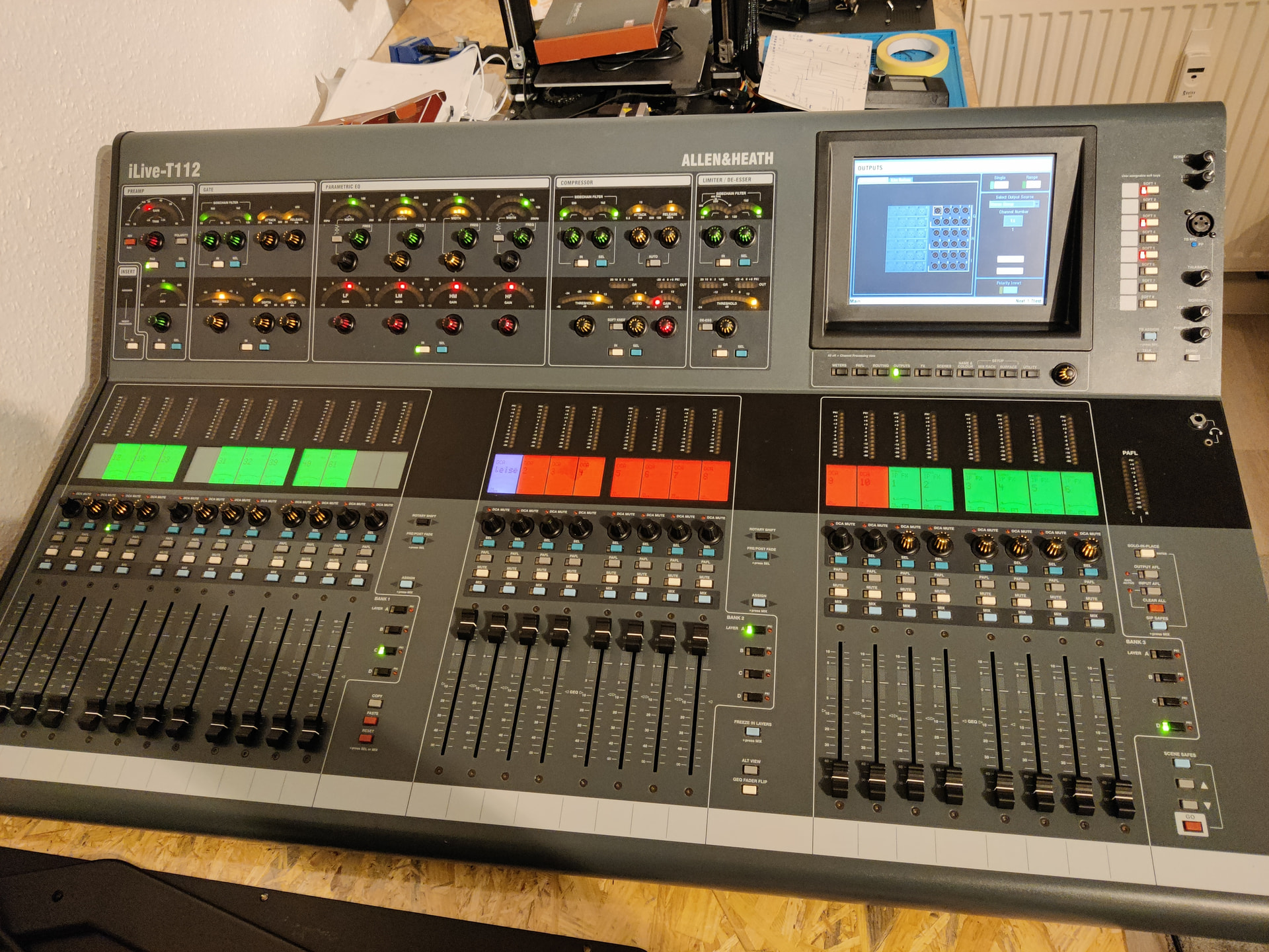

iLive T-112 has arrived
Its here :wink:
Nice console! Whats the plan?
Thanks :slight_smile:

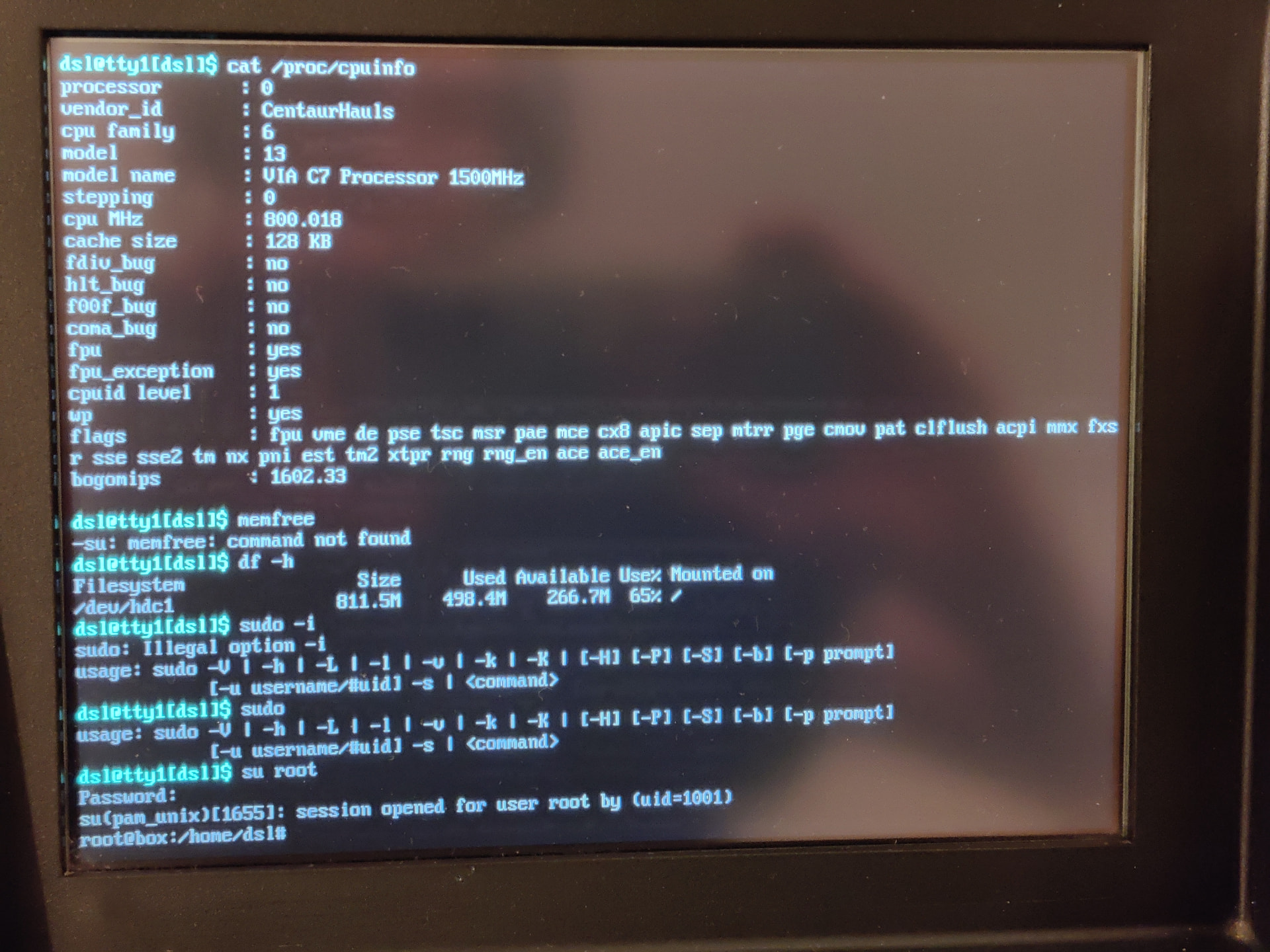

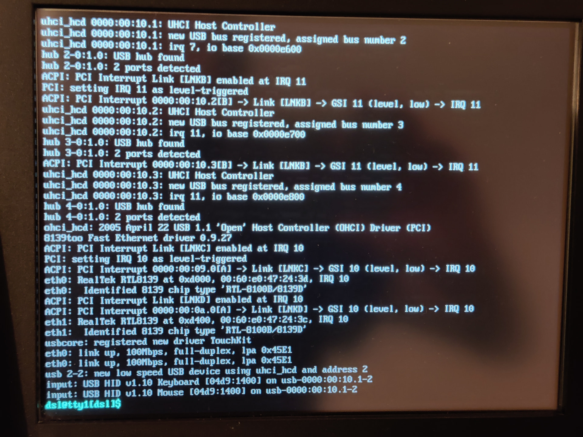

Plan is to clean, play around and try to understand the device and integrate it into the OpenMixerControl Ecosystem.
Currently we try to get the AES50 Port of the X32 to speak ACE, so we can connect both systems and exchange audio data and more…

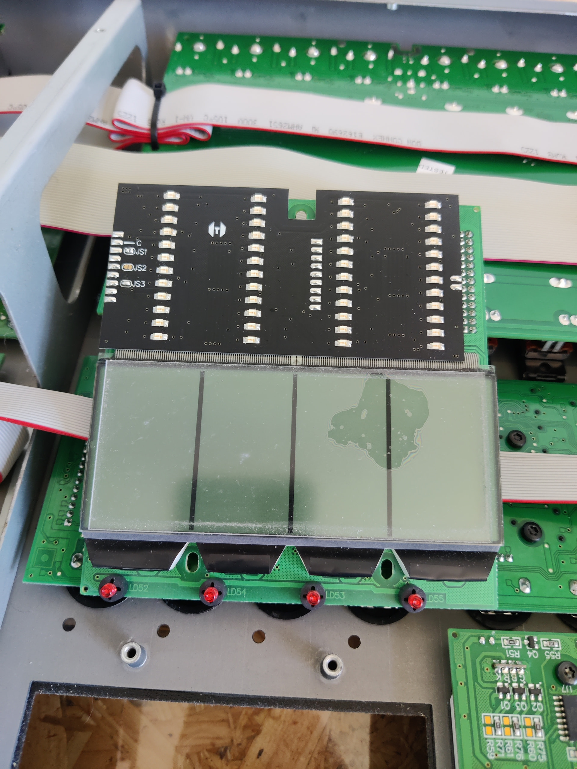

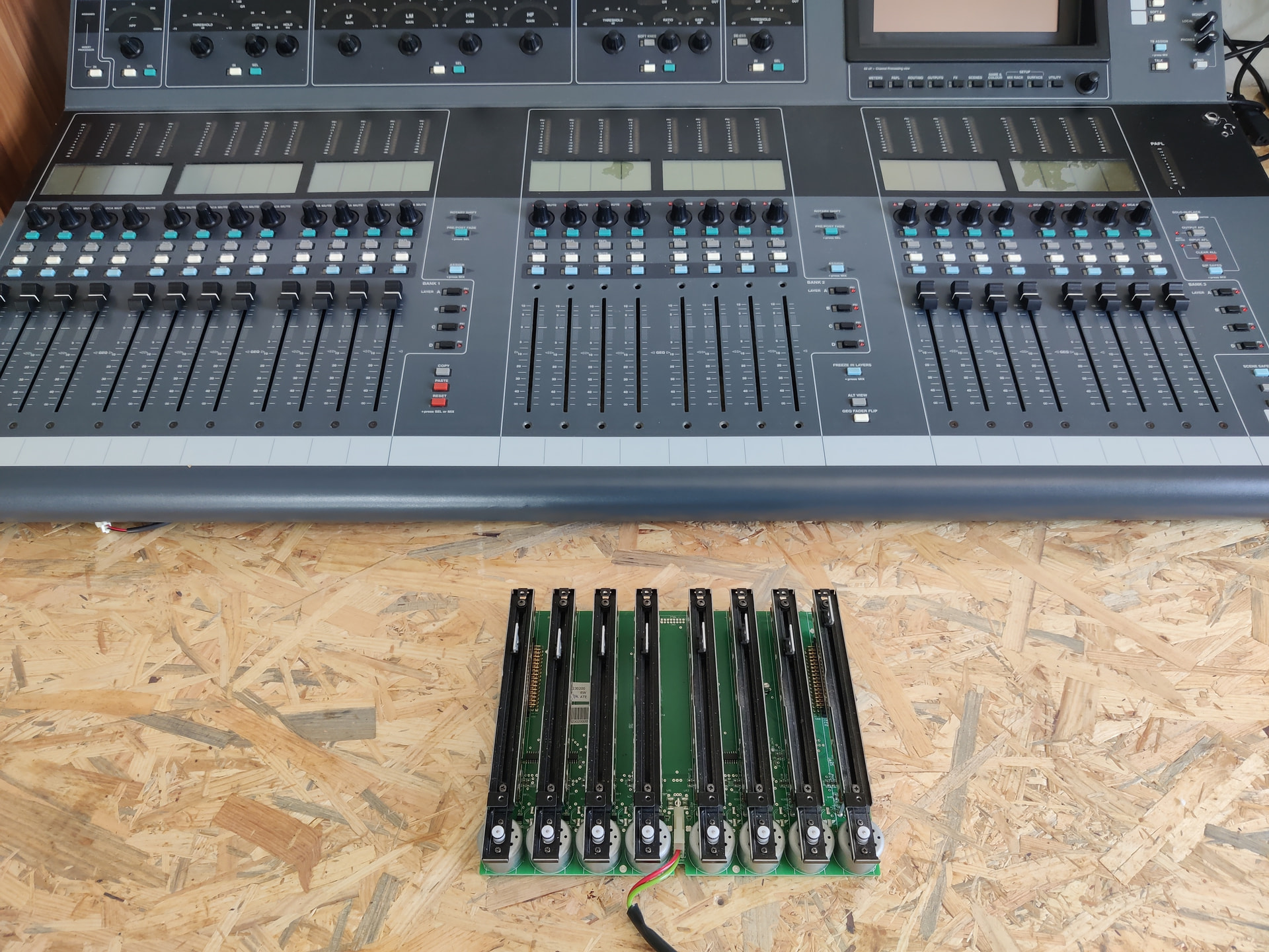

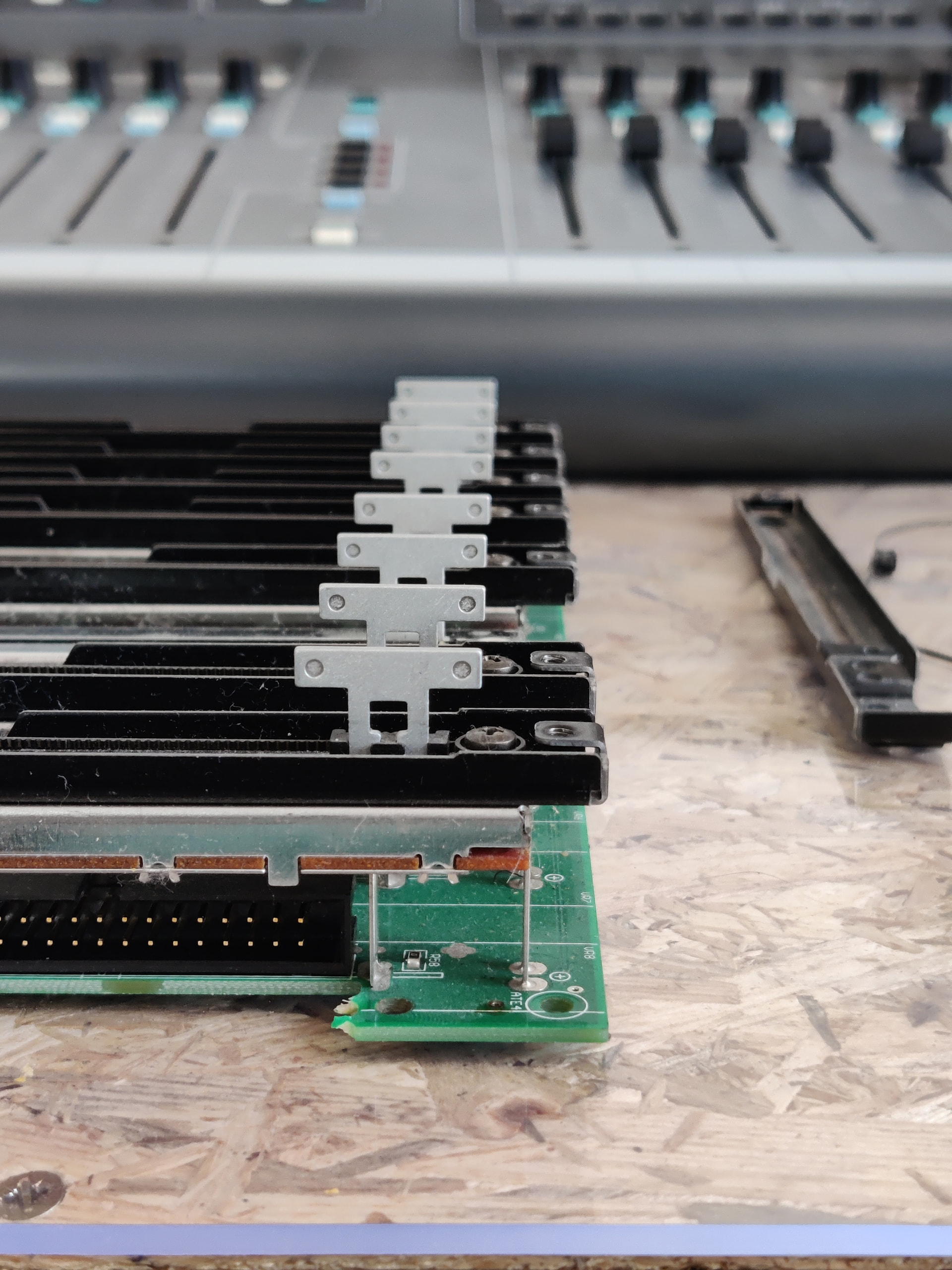

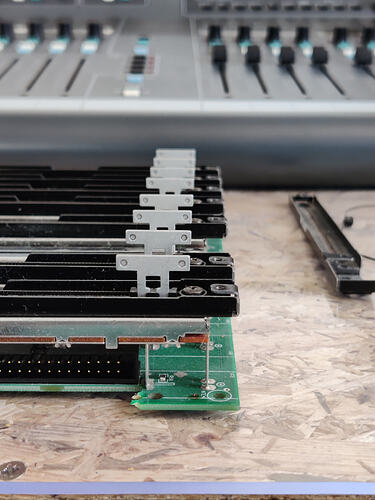

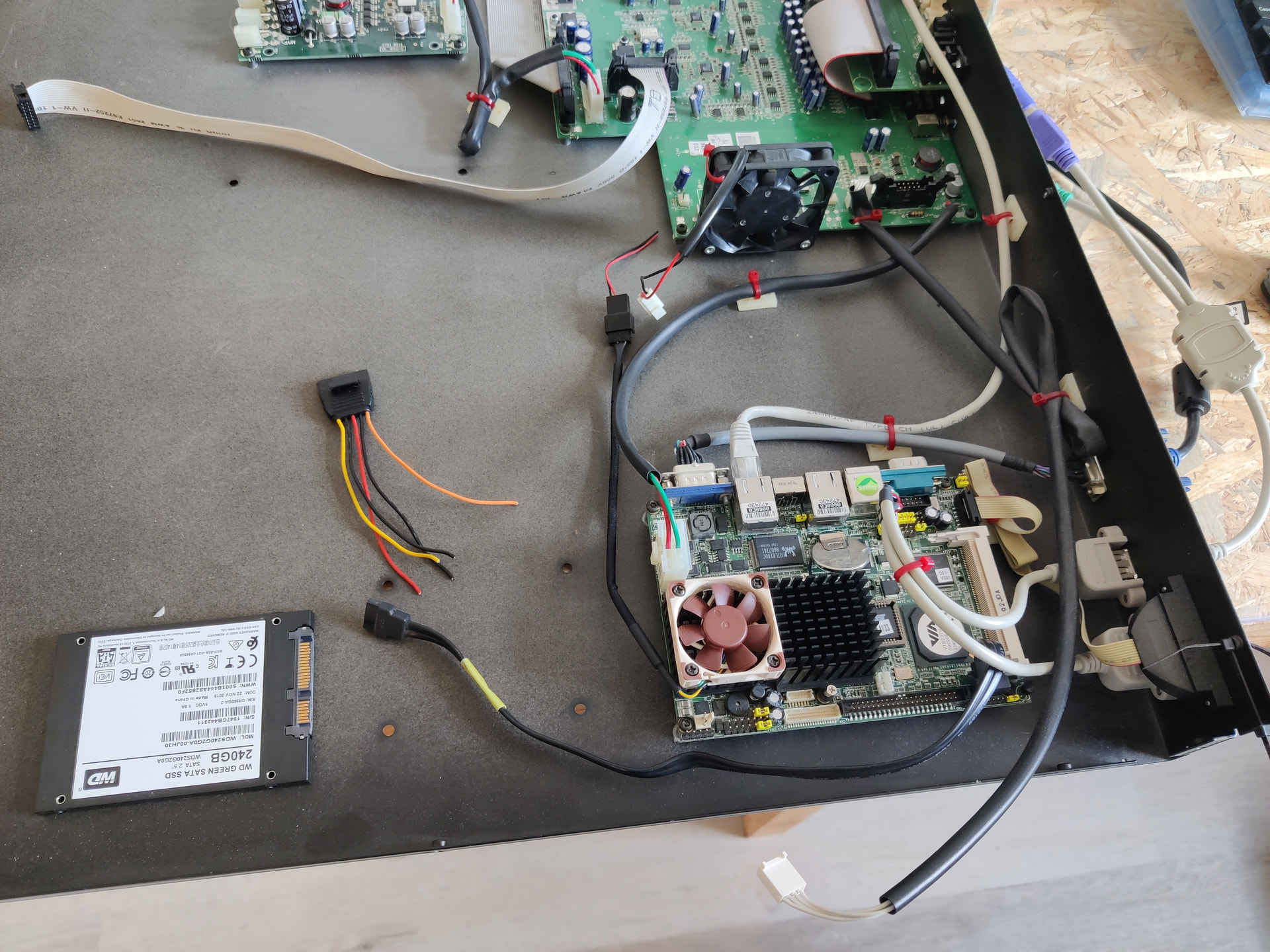

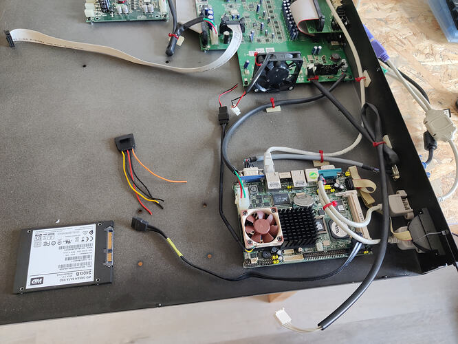

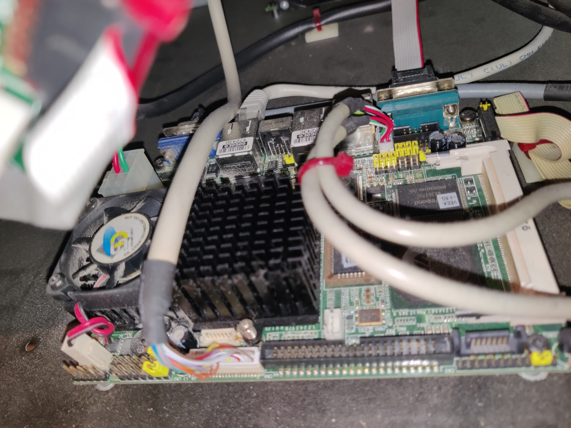

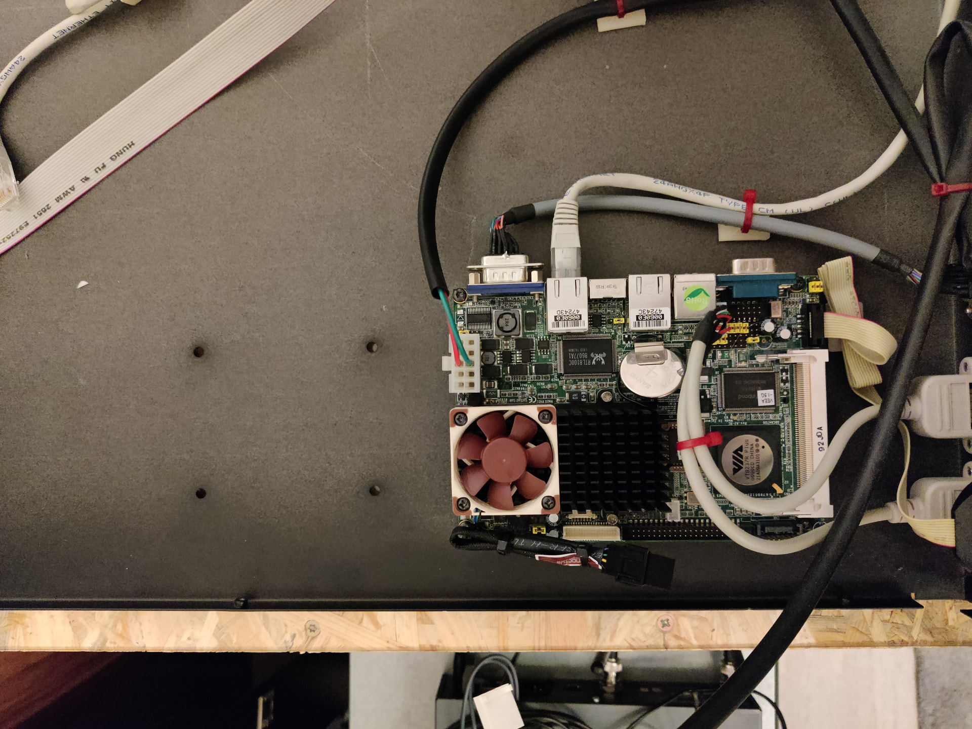

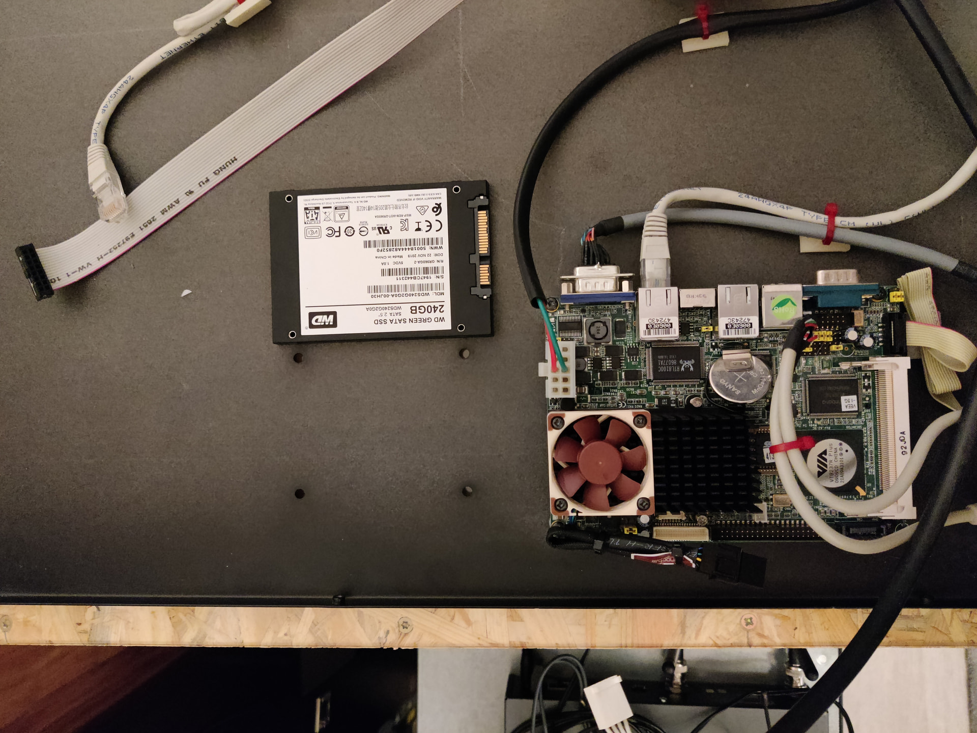

Cleaning is done!

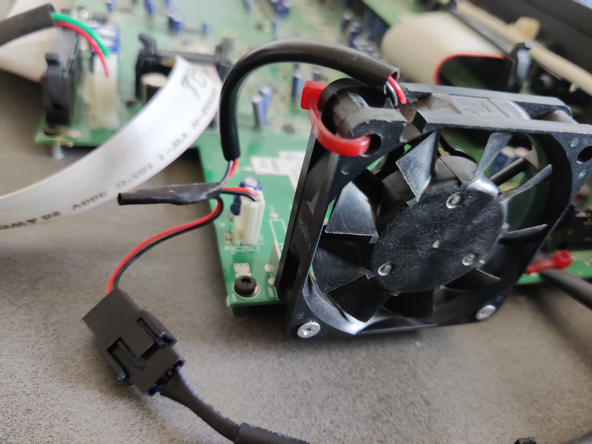

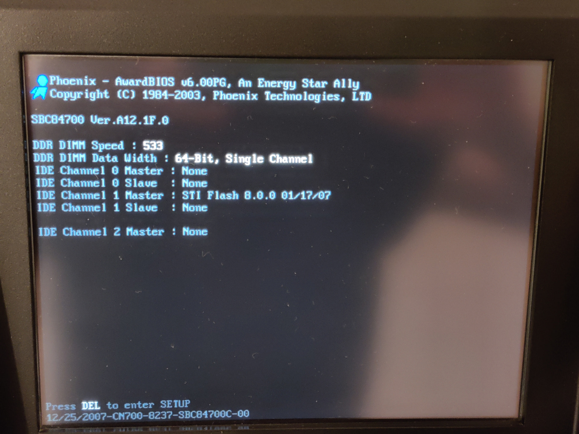

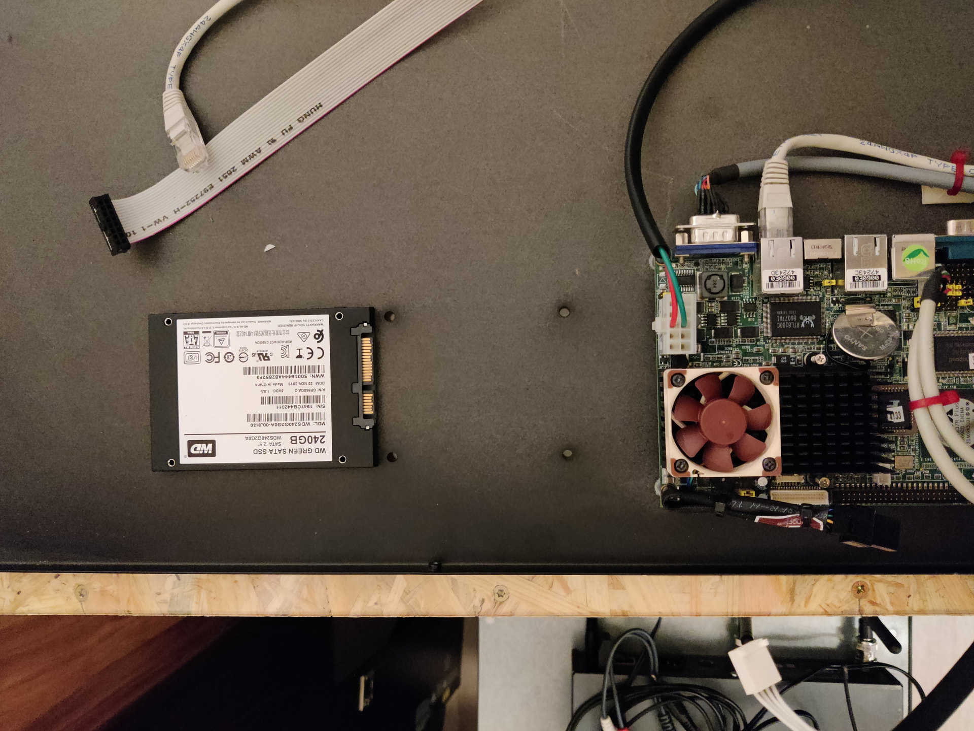

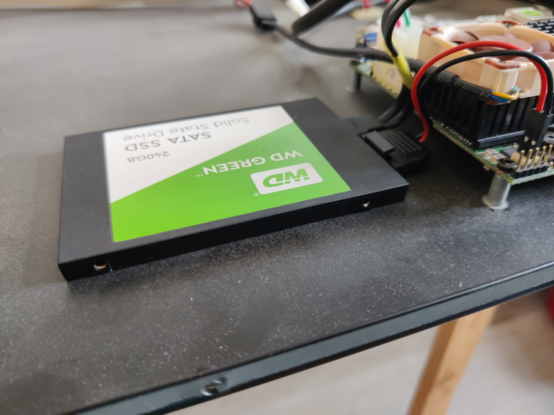

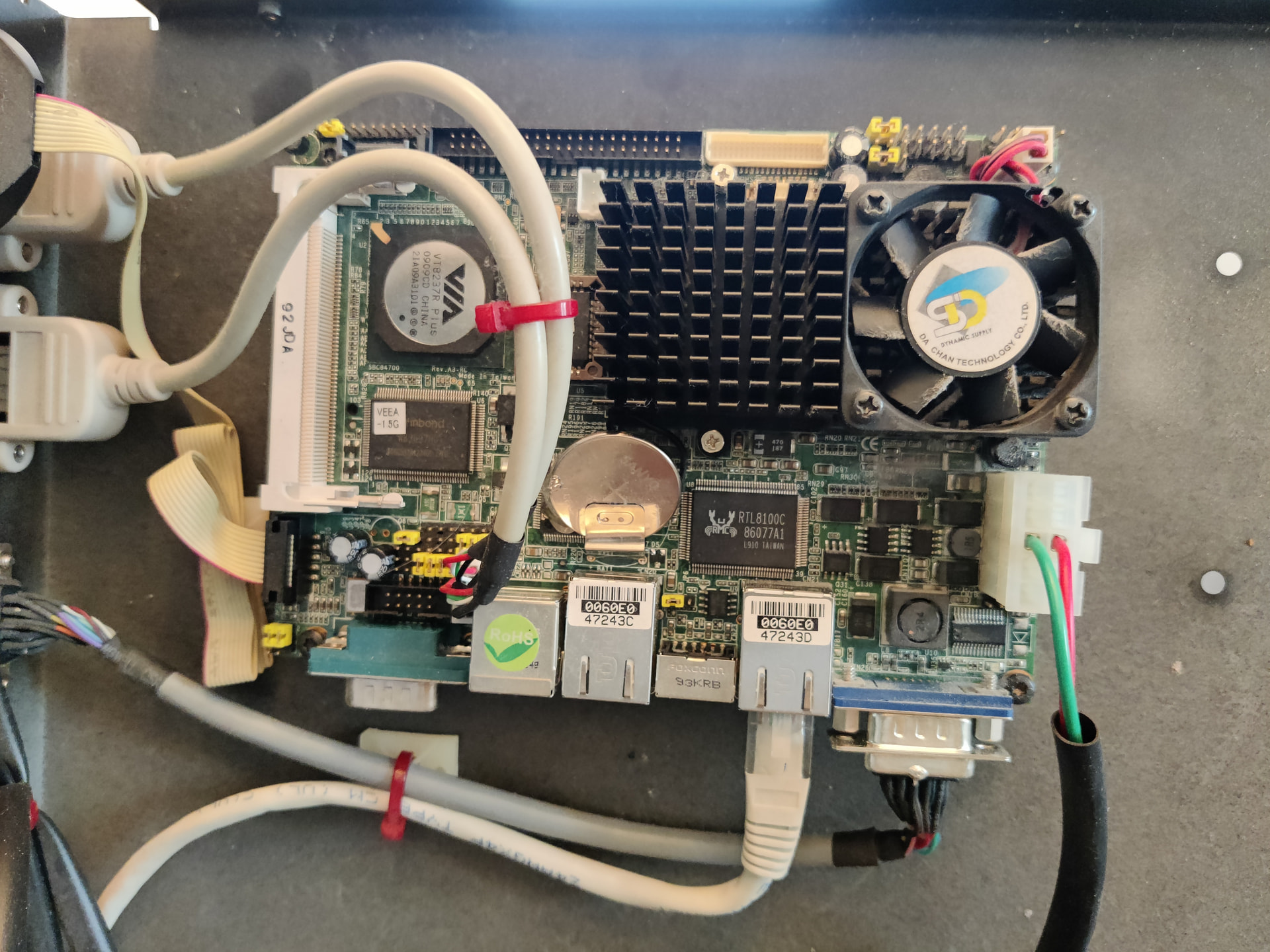

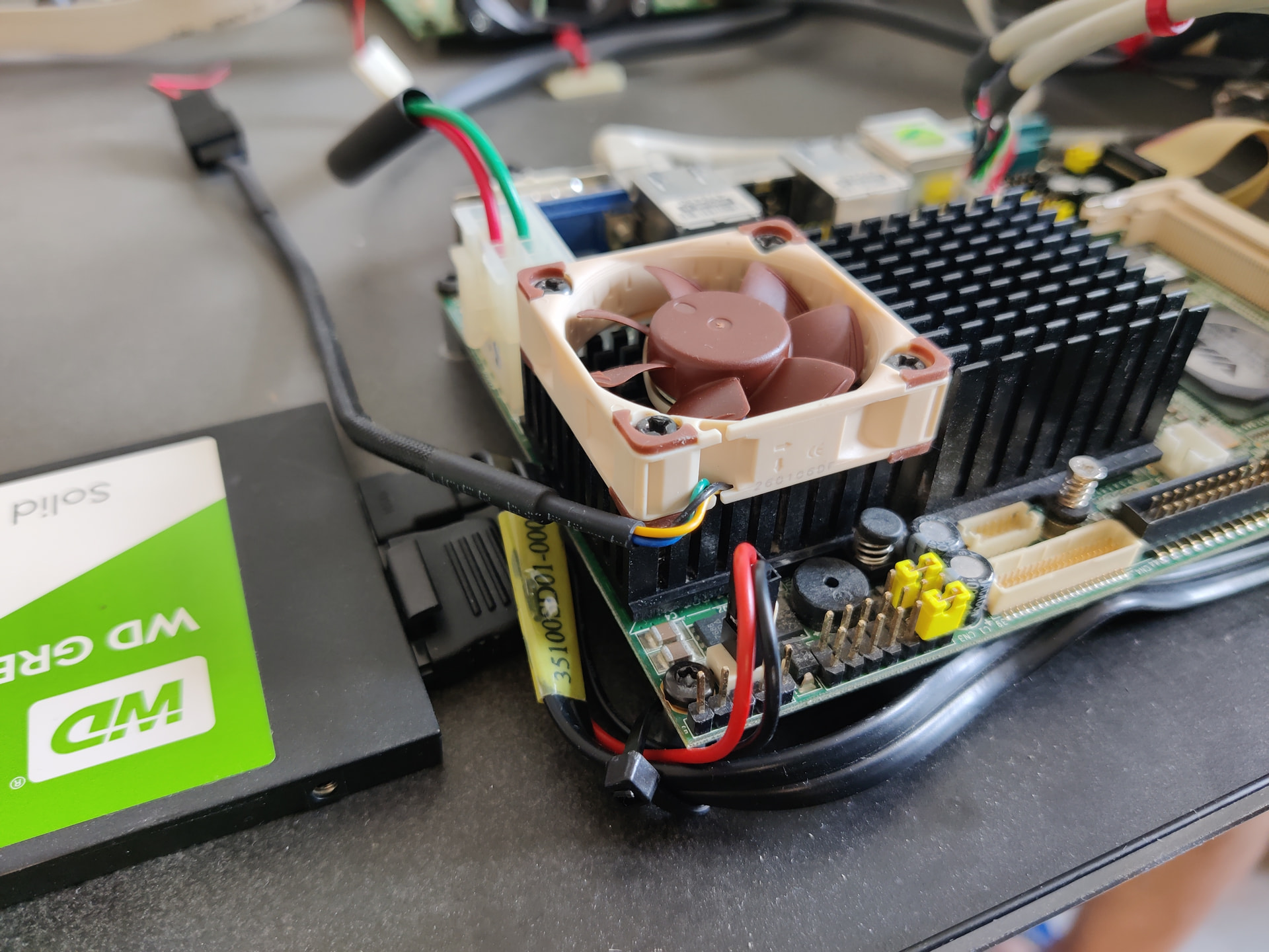

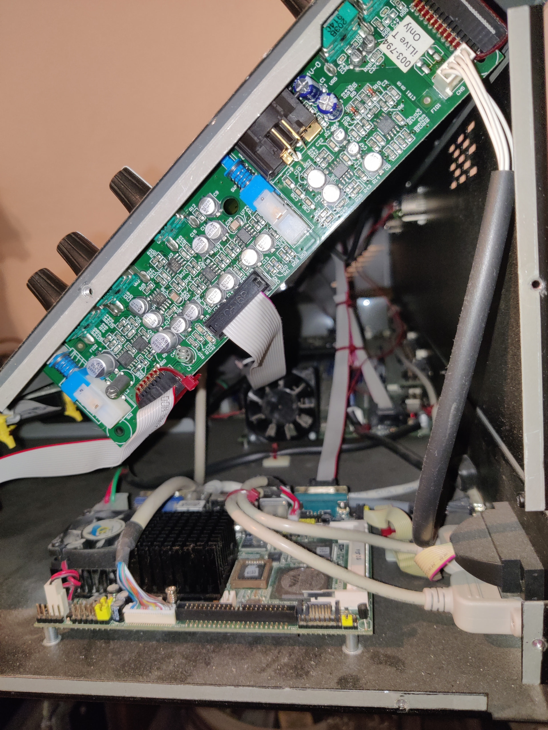

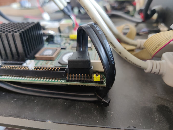

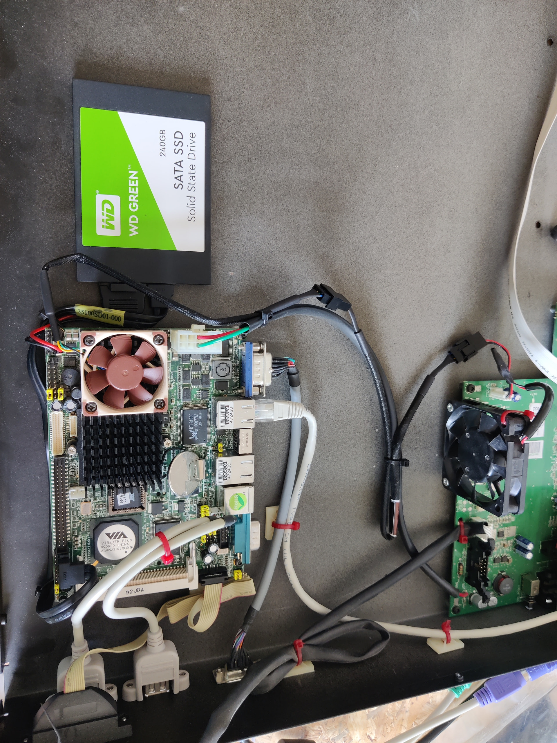

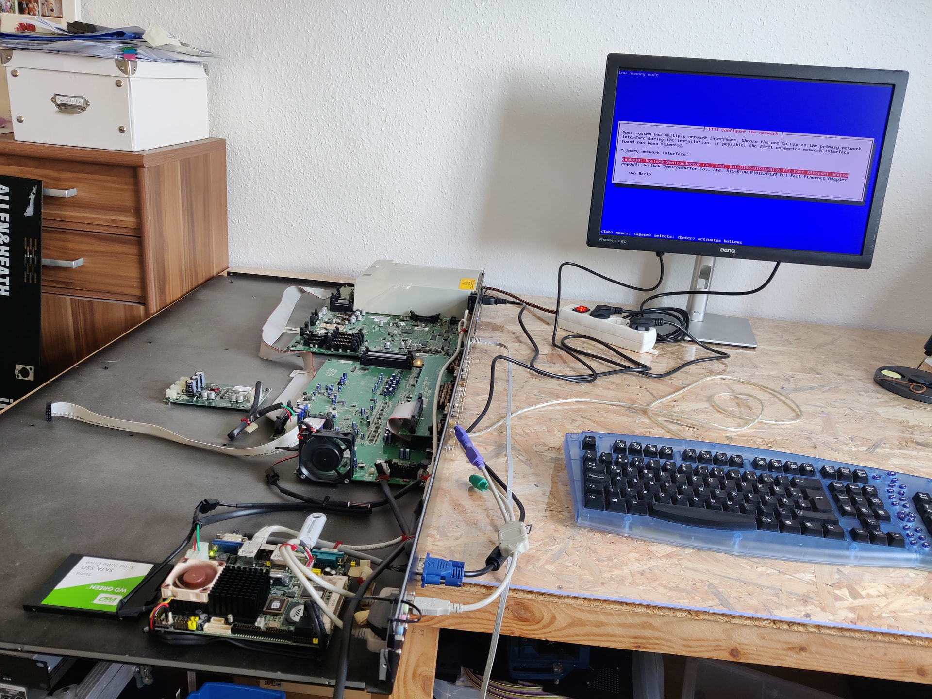

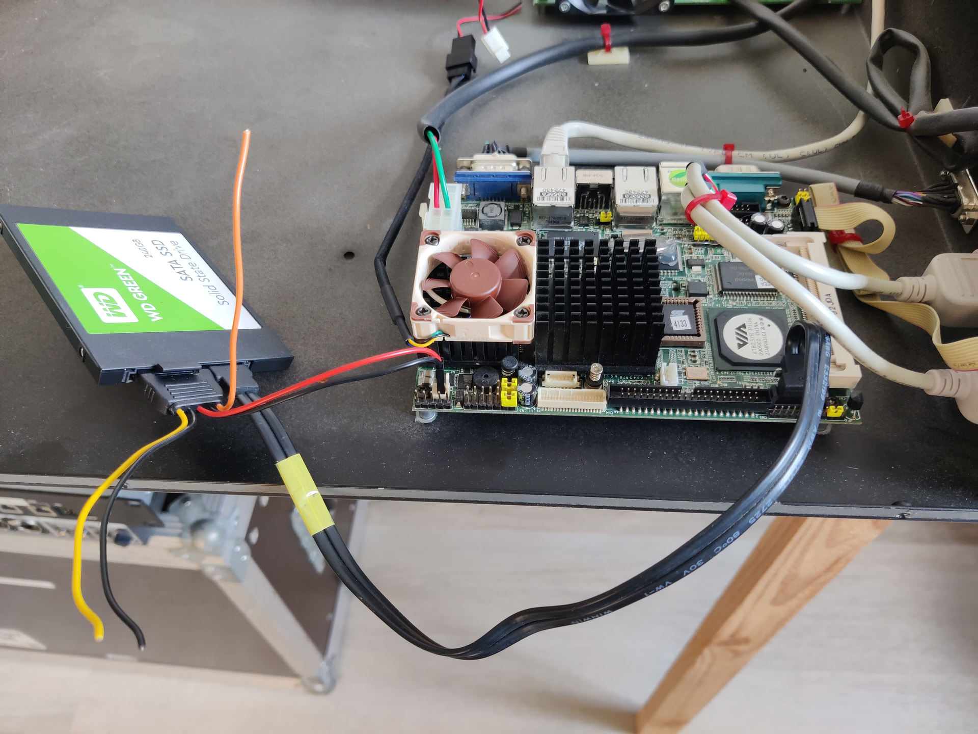

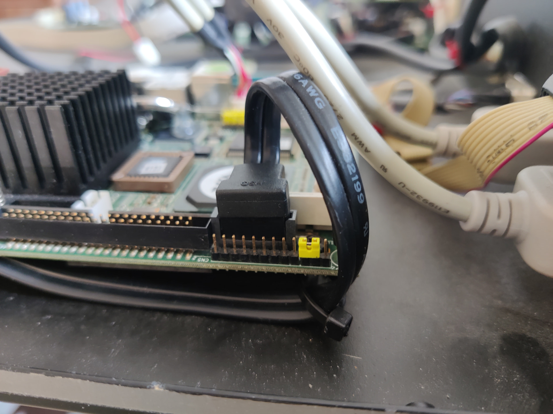

I also replaced the little fan on the SBC, added a SSD on the SATA-Port and installed Debian on it for future use with OpenMixerControl.

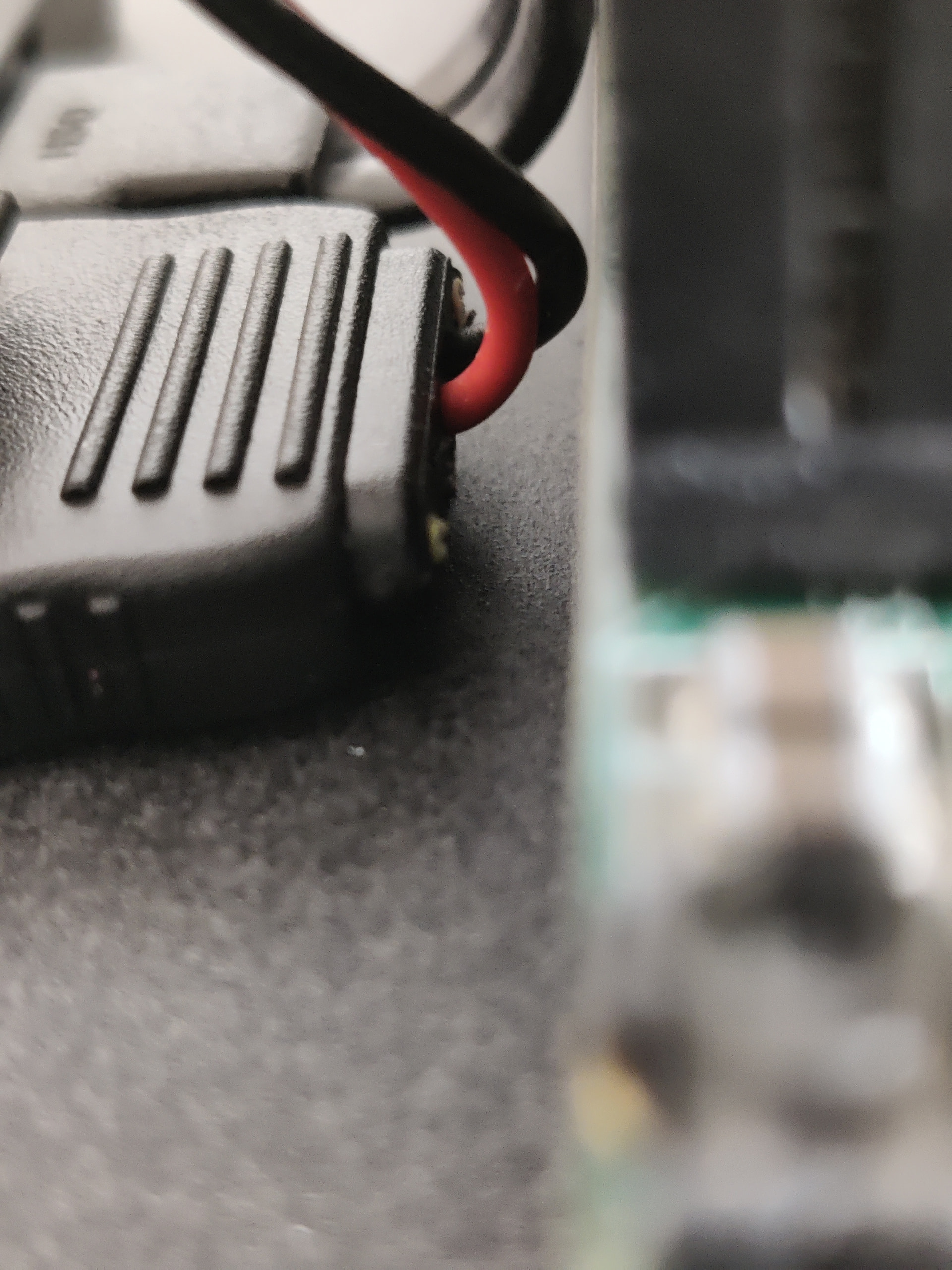

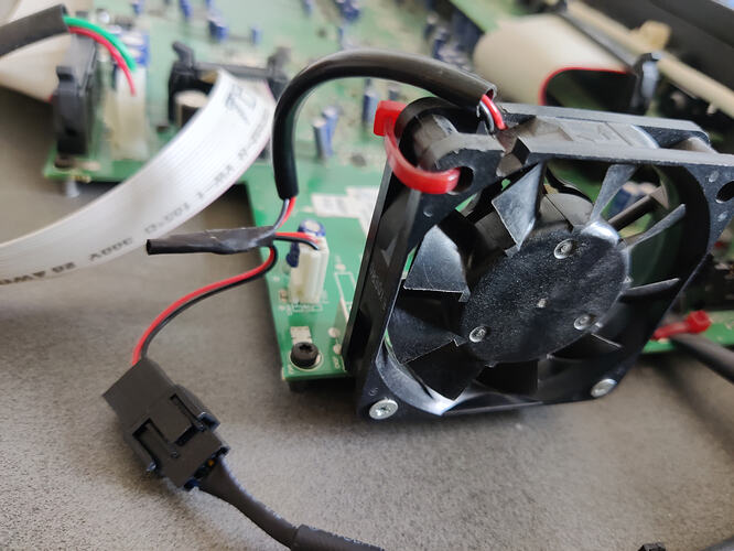

SSD-Mod and new Fan (connected to other 24V fan, so we can use the original 5V connector of the fan for the SSD)

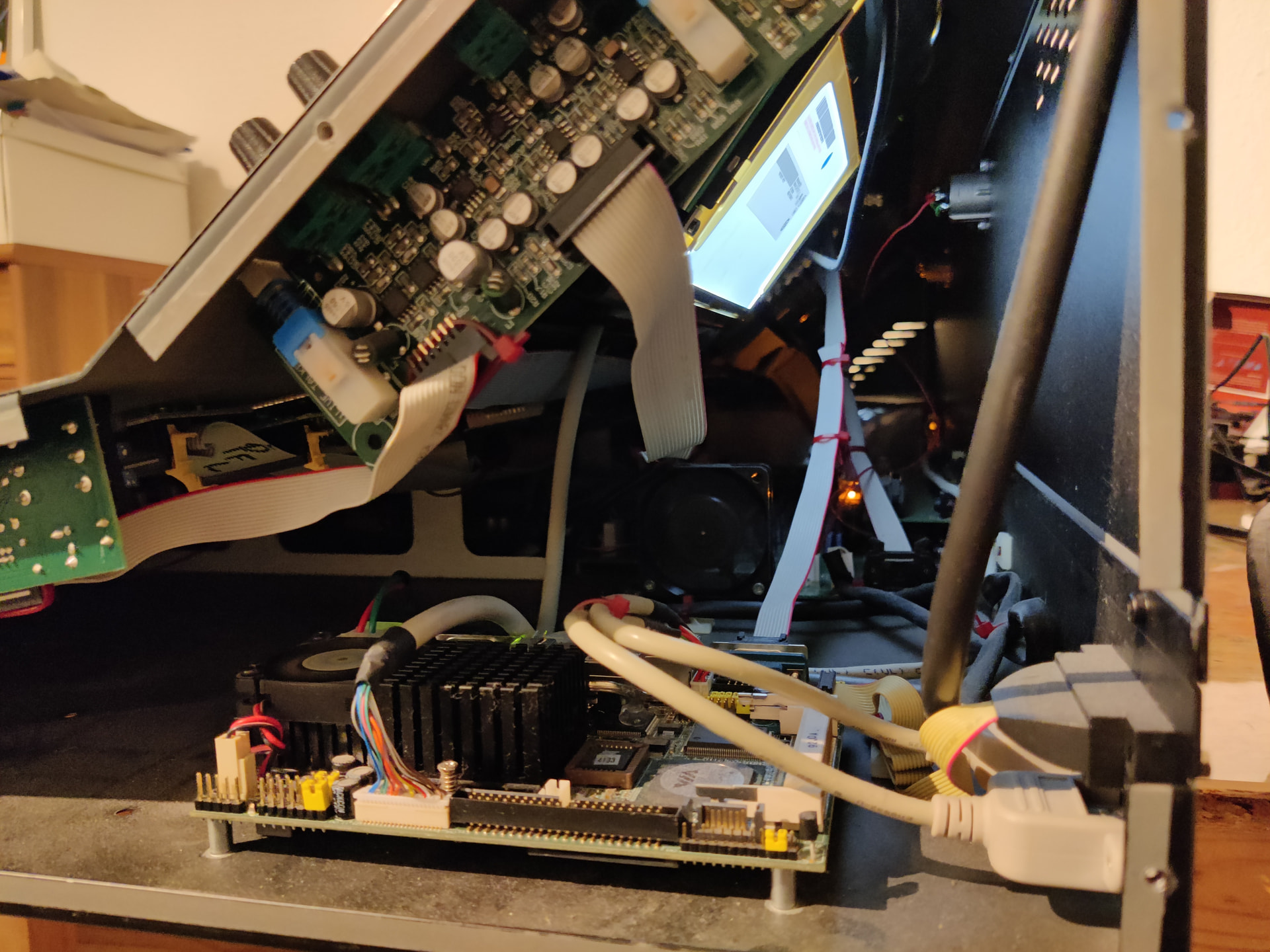

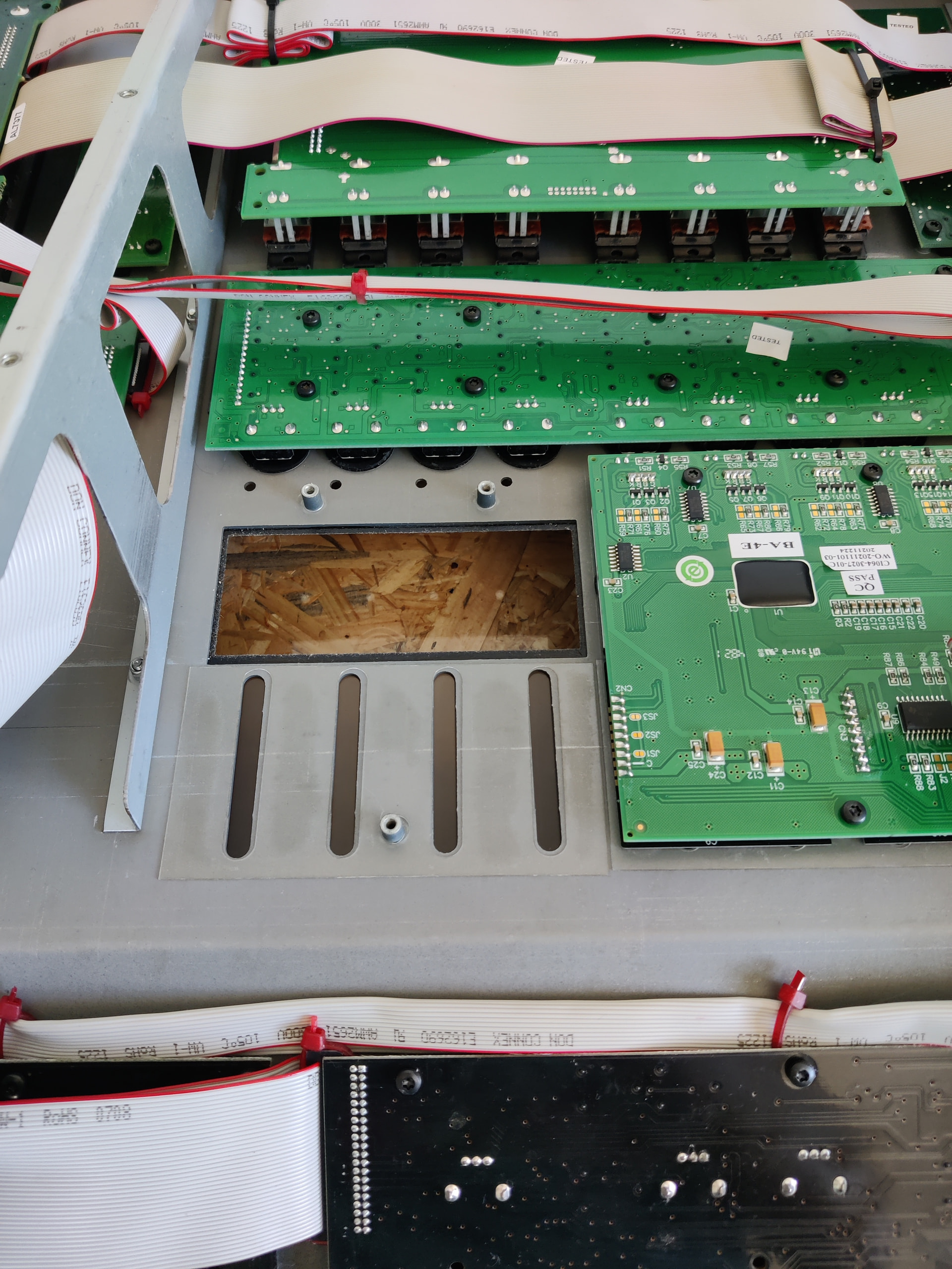

I admire your confidence in taking this console apart. Also amazing to see the little SBC there, looks so basic when you see it there! Has it been easy to take apart/clean/maintain?
It was not complicated, but you should know what you do and why :wink:
