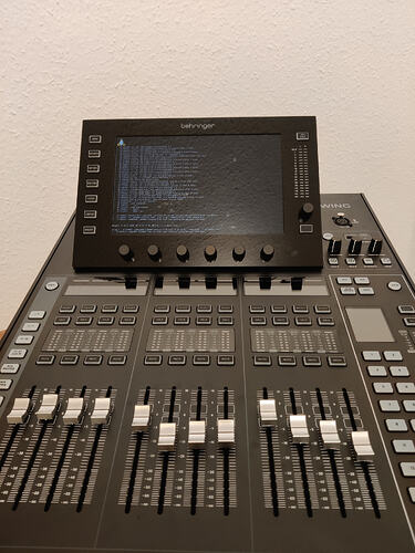

Linux is successfully booting on the WING!
There is just a broken busybox right now​:eyes:

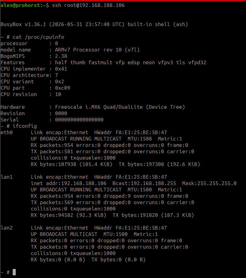

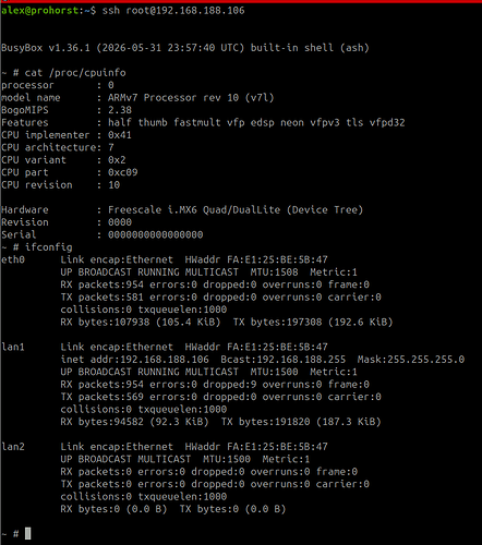

Also my first goal is to get networking, then the display, and then doom running :smiley:

@niklasarnitz I tried it and I don’t get a console via screen :cry:
the ACM device is there, but it doesn’t respond
Wait a second

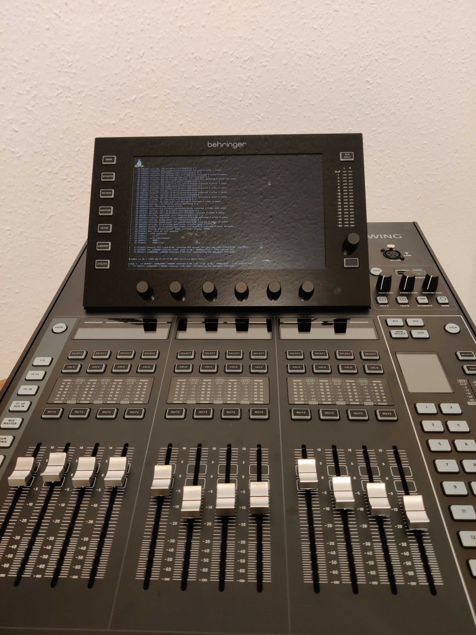

This is what my Wing Compact said to me :melting_face:
BusyBox v1.36.1 (2026-05-21 17:12:20 UTC) built-in shell (ash)
wing# dmesg

wing# cat /proc/cpuinfo
processor       : 0
model name      : ARMv7 Processor rev 10 (v7l)
BogoMIPS        : 2.38
Features        : half thumb fastmult vfp edsp neon vfpv3 tls vfpd32
CPU implementer : 0x41
CPU architecture: 7
CPU variant     : 0x2
CPU part        : 0xc09
CPU revision    : 10
Good big news! :rocket:
Linux and userland tools building now without issues and I can boot Linux on my Wing Compact and log in via SSH :heart_eyes:
@niklasarnitz did a great Job!

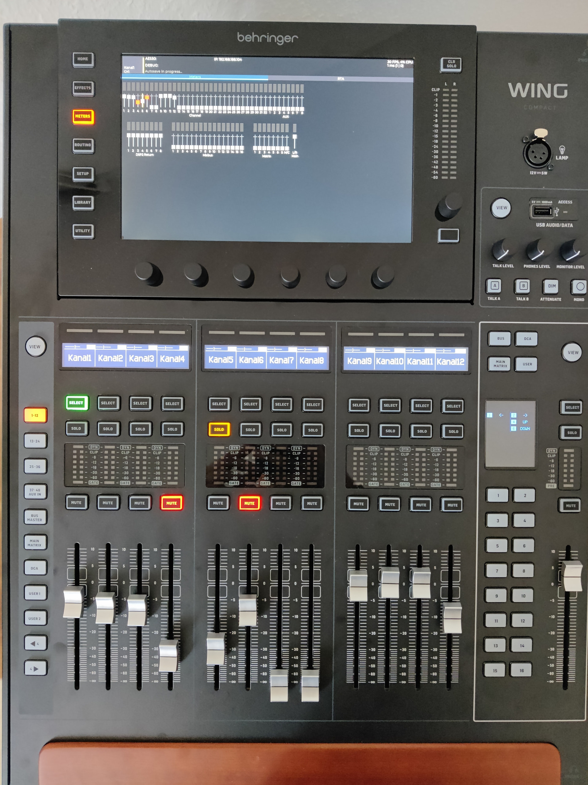

Even the display works!
Buttons, Faders and Displays work, but none of the audio hardware (yet).
