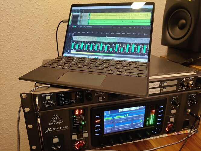

Playback of Multichannel Recording from DAW → X-USB-Card, with our new VU-Meterbridge :star_struck:
CPU-Load is around 80%, in idle (no VU-Meter change) about 30%… so we need to improve our gui code quite a bit :laptop:
But sound is clear like in the original firmware :speaker_high_volume:

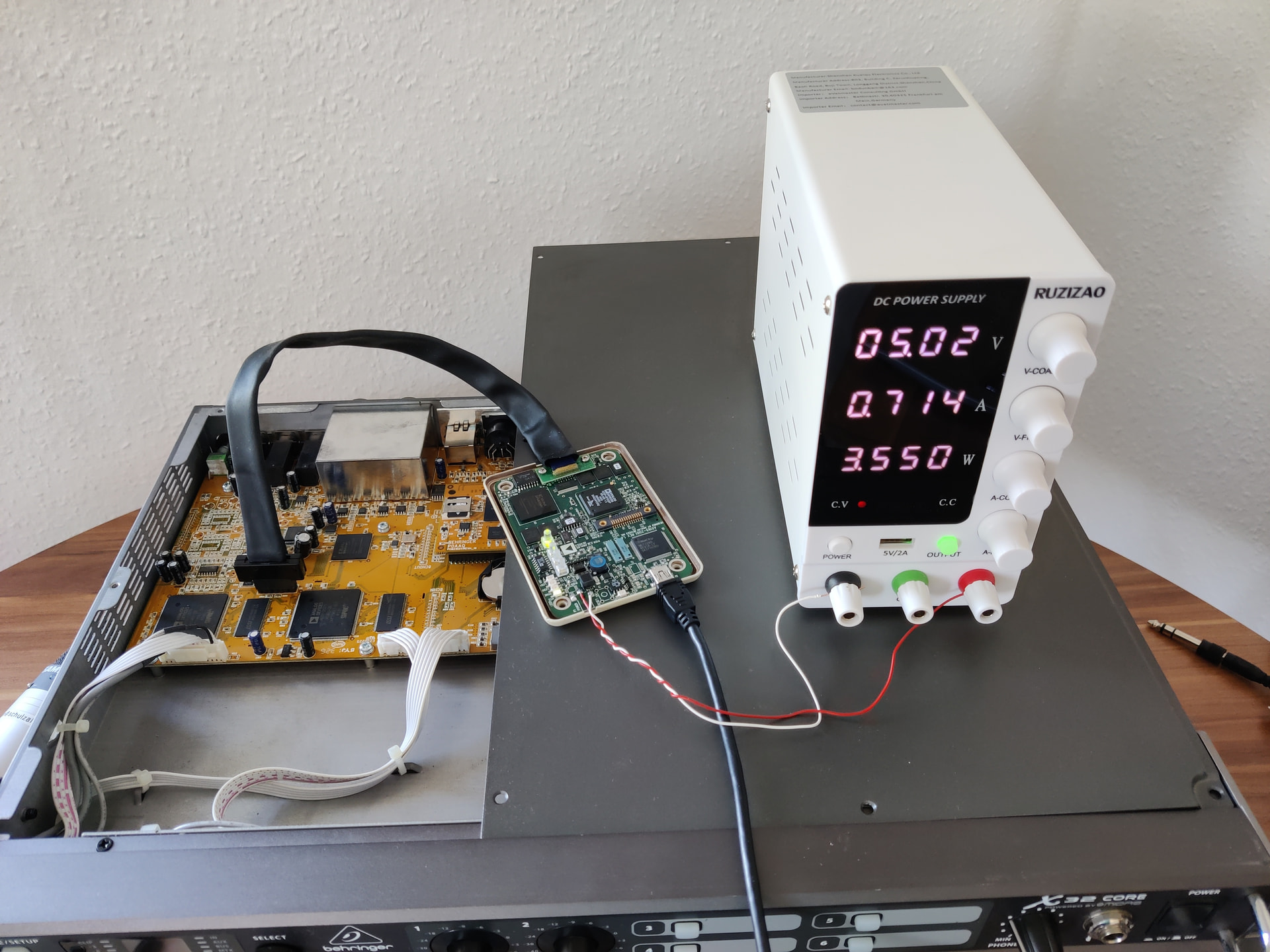

OpenX32 runs also on Behringer X32 Core:

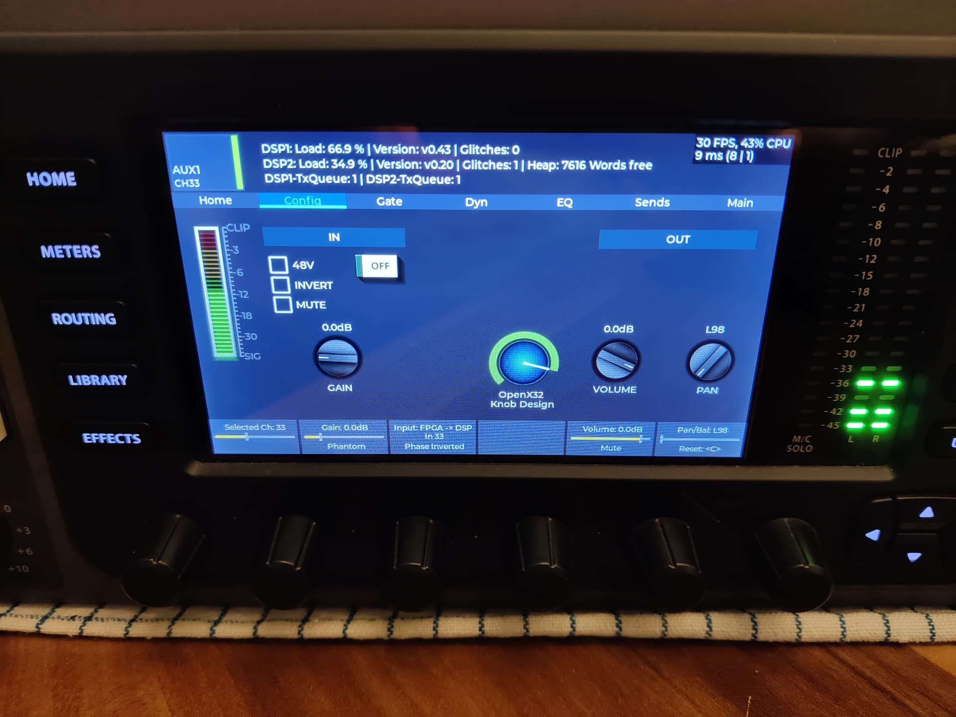

We need some help to make the GUI pretty: OpenX32 GUI Design · Issue #51 · OpenMixerProject/OpenX32 · GitHub

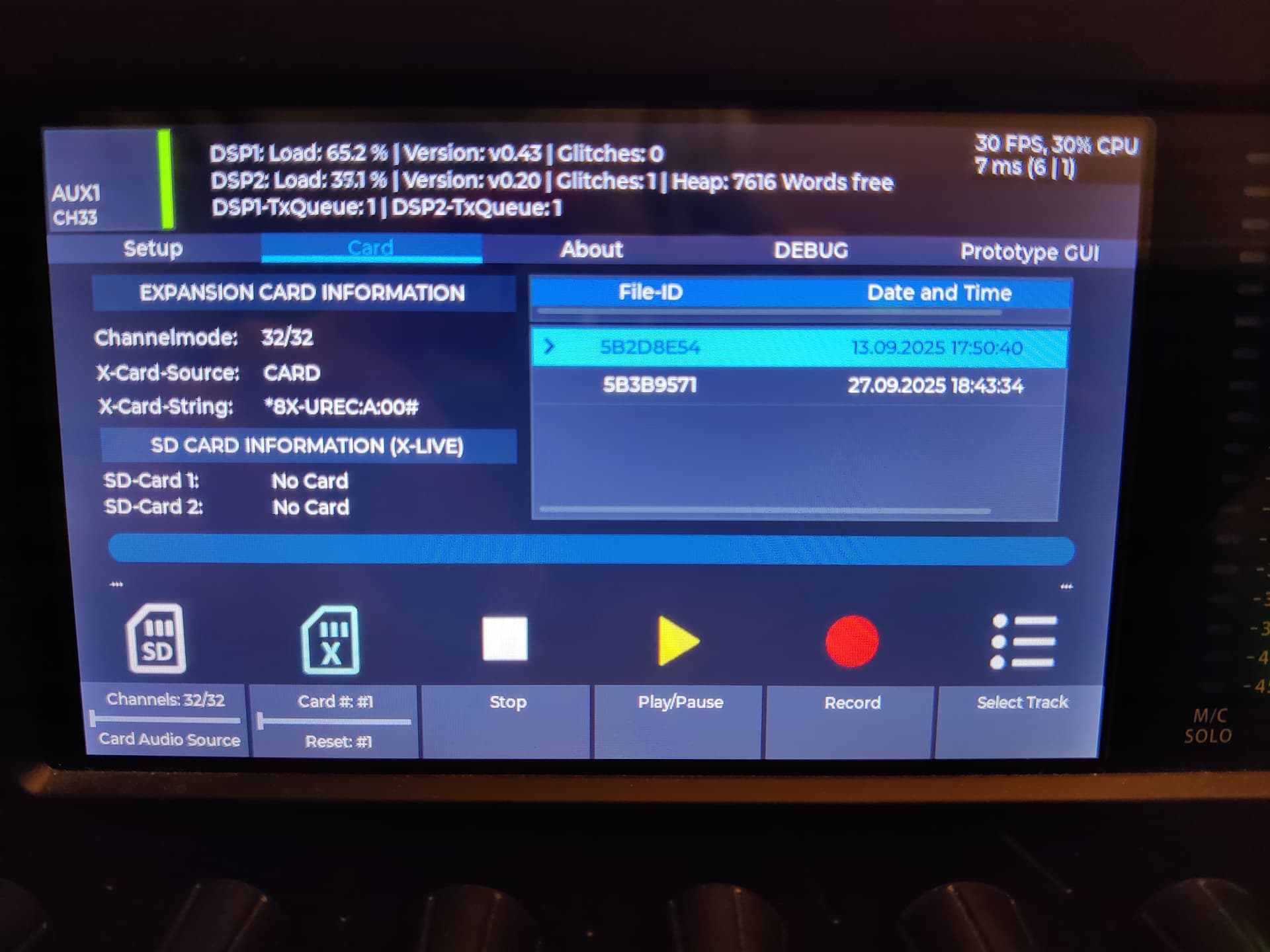

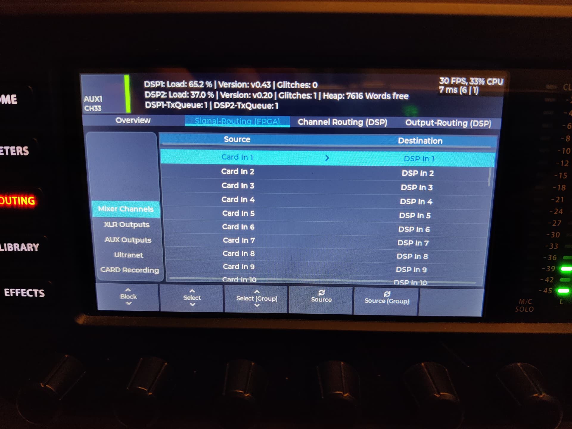

We made progress with the UI and the X-LIVE Card integration:
