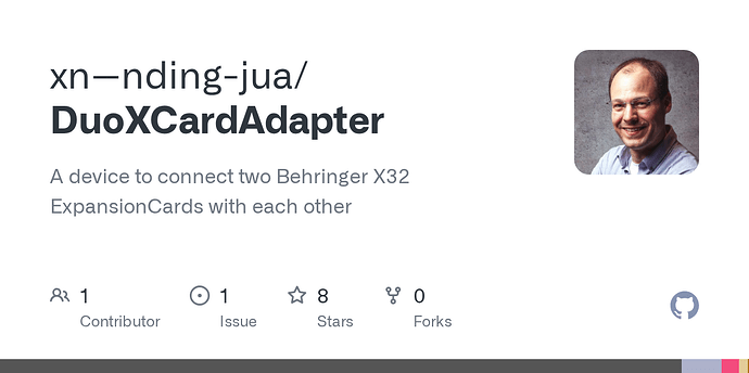

sorry for the long delay - I did not see this message from you up to now. Yes, you are right, the product-number is irritating but “TX24-40R-LT-H1E“ is correct. I used it for my DuoXCardAdapter here:
